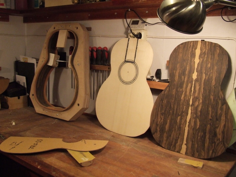

just started a new build, my second try for a 00. Its going to be a 00-42ish guitar, but with som modifications to make it a little 'larsier'.
Question no 1:
This is my first build with ziricote, and a few things strike me. Ive played one or two guitars made with ziri by others, and, yes they sounded really good. But, as I hold this back there is NO taptone at all. Ive taken it down to .085" and its still heavy and stiff, so whats up with this wood?

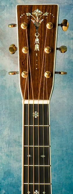

Do you guys know of anybody selling a traditional torchstyle headstock inlay like this?

I see Andy DePaule has a headstock inlay that looks pretty close: http://www.luthiersupply.com/pegheadinlayTradpage.html
PostPosted: Mon Oct 22, 2007 5:38 am

Thanks wayne, I'll go ahead and order that!

David Nichols at Custom Pearl Inlay in Malone NY can supply the pearl pattern.

You could also use wooly mammoth ivory. Don't think they are going to get
poached anytime soon...and if they are it would be on an episode of Lost.
And I've regularly taken small guitar backs down to .70 with no problems.
Ziricote likes to crack, but that's not going to change with a few thou off.
Looks like it's going to be a stellar guitar.

By the way DePaule's inlays are top quality, none better if you want natural shell cut buy some of the most talented shell workers in Vietnam. I am sure the labor price is is much less than what Nichols gets. but the shell and the work from Andy DePaule is just as good.

[QUOTE=John Mayes] You could also use wooly mammoth ivory. Don't think they are going to get
Looks like it's going to be a stellar guitar.[/QUOTE]
Thank you John. Yes, if its already extinct I guess it cant complain over it.
How is your general experience with ziricote, is it always having a very dull taptone, or is it just this partcular piece that has inbuilt tensions or something that kills the tone?

I have ordered from Andy depaule previously, but only strips so those didnt show any precision work.
Looks like I'll order the torches from him then!

[QUOTE=Lars Rasmussen] [QUOTE=John Mayes] You could also use
something that kills the tone?[/QUOTE]
I have liked the Ziricote I've worked with. It has always had nice tap tones
and the guitars ended up nice in the final product as well. But I've seen,
time and time again, ziricotes propensity to split for no rhyme or reason.
Never the less I'd still work with it. It makes very nice guitars, and your
set looks amazing.

John, thanks for sharing your experience with Z. Guess I'll take it down some more and see if it comes.
